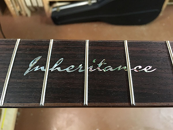

You can drill shell, I do it all the time to insert the blade on my jeweler's saw for internal cuts such as the inside of of letter O's. But these are tiny bits. If it were me, I'd use the approach Dennis mentioned, and I would bevel the edges of the shell around the holes to help prevent breakage. I do this with inlays that cross fret slots and have never had a piece of shell break.

Interesting inlay, Greg. Is that as in what you have wasted on this lutherie thing? If so, I need to do a series that, in addition to "inheritance" includes: "youth", "sanity", "harmony", and "potential". [FACE WITH TEARS OF JOY]

LOL I hear you! The inlay was requested by the customer, who is a worship leader. The word 'inheritance' has biblical significance.
